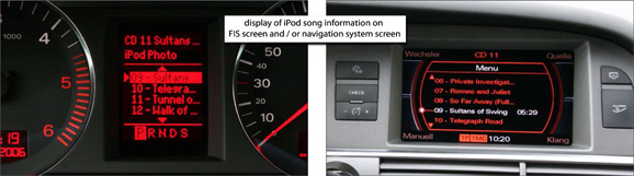

AMI original: sobre los 640€ http://www.fourtitude.com/news/uploads/Fea...led_600_044.jpg
DENSION Gateway 500 for audi: 385€ http://www.dension4u.de/shop/images/einbau...w500_en_578.jpg
IPOD VIDEO AUDIO 30GB: 270€ http://www.thevooner.com/feature/2005/11/13/ipodv/video1.jpg
