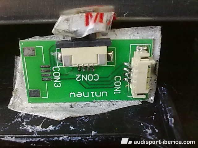

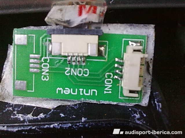

Rushifuru Publicado 2 de Mayo del 2010 Denunciar Publicado 2 de Mayo del 2010 Hello, I'm Luca from Italy!I bought the same kit, but when I opened the packet, I didn't find this part: The seller (nf-elektronik) told me that his kit doesn't have this part...but on the photos sent for the installation guide there is! Now I contacted ebay/paypal, but the seller tell me that all his kit are without this part. Do you have other photos of this part? If it's only a connection between the MMS cable and the touch panel cable, I can solder directly the two cable.. are there any components on this board? thank you bye from Italy Luca Hello Luca, I do not remember if it has any component on this board, but I think he has nothing, only the connectors.Tomorrow I will watch. Greetings Thank you very much! I will wait these informations! If there aren't components, I can solve very easy!!! bye Luca Ya he mandado un privado a Luca comentandole que la plaquita en cuestion es solo un conector y que no lleva ningun componente electronico. Lo comento aqui tambien por si a alguien le sirve Un saludo Responder
Il Signor Zetec Publicado 2 de Mayo del 2010 Denunciar Publicado 2 de Mayo del 2010 thank you very much for your reply! I build a connection ECU with a old flat cable connector from a old CD-ROM writer: all work perfectly! I have only the bluetooth that doesn't work: I listen, but they don't listen to me. I tested the microphone in my pc and it's ok, the wiring loom from the ECU to mic is ok, tested with a tester. I hope that it isn't the ECU...but what can be??? This ebayer NF-ELECTRONIK is no serious... Responder
Rushifuru Publicado 2 de Mayo del 2010 Denunciar Publicado 2 de Mayo del 2010 thank you very much for your reply! I build a connection ECU with a old flat cable connector from a old CD-ROM writer: all work perfectly!I have only the bluetooth that doesn't work: I listen, but they don't listen to me. I tested the microphone in my pc and it's ok, the wiring loom from the ECU to mic is ok, tested with a tester. I hope that it isn't the ECU...but what can be??? This ebayer NF-ELECTRONIK is no serious... Hi Luca, It is good to hear my solution was useful to you, I think you must revise the microphone connection with the interface, because they doesn't connect always fine. I regret I can't be able to help you more because I didn't install the mic, I have the original audi's mic. With my poor Italian... "Buona fortuna" my friend Responder

Il Signor Zetec Publicado 2 de Mayo del 2010 Denunciar Publicado 2 de Mayo del 2010 (editado) Hi Luca,It is good to hear my solution was useful to you, I think you must revise the microphone connection with the interface, because they doesn't connect always fine. I regret I can't be able to help you more because I didn't install the mic, I have the original audi's mic. With my poor Italian... "Buona fortuna" my friend thank you very much! GRAZIE! For the mic, are there any other users that had the same problem? bye from Naples: Editado 2 de Mayo del 2010 por Il Signor Zetec Responder
Rushifuru Publicado 2 de Mayo del 2010 Denunciar Publicado 2 de Mayo del 2010 (editado) Y que (sin ser muy pelota, mejor dicho nada pelota) sois una panda coj..... (seguro que TODOS pero por lo menos los que nos conocimos en el kinepolis en el montaje de cendri) gracias al tema del navegador hemos compartido venturas y desventuras y aprendi mucho de los "gurus" del foro y asi que cuando alguien pregunta algo intento ayudarle en lo que puedo. Vaya tela lo que hace el no parar a descansar el fin de semana Me referia al montaje del navegador en el coche de BARCI no de cendri, el cual junto con batallas, superraton y todos los que pudieron instalaron su navegador con camara Un saludo Por cierto, alguno sabeis algo de lo que pregunta el amigo italiano? El tema de la pantalla tactil ya lo tiene solucionado, pero ahora lo tiene con el bluetooth. El escucha al interlocutor en el altavoz del interface, pero a él no le oyen. No sabe que es, porque ha probado el microfono en el ordenador y si le funciona y el manojo de cables que va del interface(ECU) al conector del micro lo ha probado con un polimetro y tambien le da como bien. Imagino que sera el conector del cable al interface ( que no haga buena conexion) o el propio interface. Pregunta si los que han puesto el micro en su navegador les ha ourrido alguna vez. A ver si averiguamos que le pasa al chaval. Gracias a todos Editado 2 de Mayo del 2010 por rushifuru Responder
