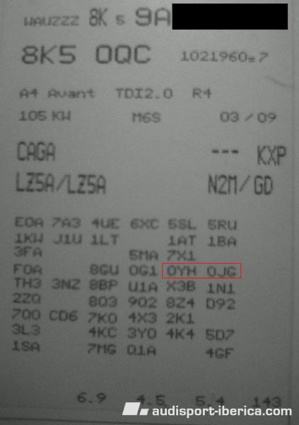

Super-Raton Publicado 10 de Enero del 2011 Denunciar Publicado 10 de Enero del 2011 (editado) Supongo que será un tema tratado por el foro pero no lo veo... Se trata de los codigos PR que tiene cada coche y que estan especificados en la pegatina que va en el libro de mantenimiento... Yo me he fijado en dos en particular que creo que son imprescindibles para plantearse un cambio de suspension... (marcados en la foto con un cuadrado rojo) son los indices de peso para el modelo... En esta pagina se pueden poner los codigo para ver su significado: http://prsearch.planetvag.com/default.aspx Mis codigos son, por ejemplo: PRCode: 0G1 = gearshift lever PRCode: 0JG = weight category front axle (eje delantero) weight range 7 PRCode: 0YH = weight category rear axle (eje trasero) weight range 8 PRCode: 1AT = electronic stabilization program (ESP) PRCode: 1BA = standard suspension/shock absorption PRCode: 1KW = disc brakes, rear PRCode: 1LT = disc brakes, front PRCode: 1N1 = power steering PRCode: 1SA = without additional engine guard PRCode: 2K1 = reinforced bumpers PRCode: 2ZQ = leather trimmed multi-function steering wheel for airbag system PRCode: 3L3 = manual height adjustment for front seats PRCode: 3NZ = rear seat bench unsplit, backrest split folding PRCode: 3Y0 = without roll-up sun screen PRCode: 4GF = windshield, tinted PRCode: 4K4 = radio remote controlled central locking operated from inside and separate trunk release PRCode: 4KC = side and rear windows tinted PRCode: 4UE = airbag f. driver a. front seat passenger PRCode: 4X3 = side airbag front with curtain airbag PRCode: 5D7 = carrier frequency 868 MHz without panic button PRCode: 5RU = outer right rear view mirror: convex (large viewing field) PRCode: 5SL = outer left rear view mirror: non-spherical PRCode: 6XC = outer rear view mirrors: powered PRCode: 7A3 = CD player PRCode: 7K0 = without tire pressure warning light PRCode: 7Q0 = without navigation device PRCode: 8GU = alternator 140A PRCode: 8Q3 = automatic headlight-range adjustment dynamic (self-adjusting while driving) PRCode: 8Z4 = engine cooling system with increased cooling performance PRCode: 9Q2 = multi-function indicator/on-board computer with check control PRCode: CD6 = alloy wheels 7 1/2J x 16 offset 40 (3D0 601 025) PRCode: E0A = no special edition PRCode: J1U = battery 450 A (95 Ah) PRCode: Q1A = standard front seats PRCode: U1A = instrument insert with km/h speedometer,clock, tachometer and trip odometer PRCode: X3B = national sales program Spain (FBU) Espero que os sea util... Un saludo! Editado 10 de Enero del 2011 por Super-Raton Responder
paul2008 Publicado 10 de Enero del 2011 Denunciar Publicado 10 de Enero del 2011 Tema muy chungo..... Tu coche lleva suspensión de serie con peso en eje delantero 7 y peso eje trasero 8. Mi coche llevaba de serie peso eje delantero 6 y peso eje trasero 6. Porque llevando los 2 suspensión de serie llevamos un índice de peso diferente???????? He llegado a la conclusión que depende del equipamiento del coche. Un motor diesel es más pesado que un gasolina (a misma cilindrada), una caja automática es más pesada que una manual, llevar asientos eléctricos, navegador, techo, etc. es todo más pesado que no llevarlo. Mi siguiente conclusión es que a más índice de peso 7 --> 8 --> 9 --> 10, etc. el muelle aguanta más peso y por lo tanto necesita más peso para que baje. Por el contrario, a menos peso 7 --> 6 --> 5 --> 4, etc. el muelle aguanta menos peso y por tanto necesita menos paso para que baje. Con esto entiendo que un coche con motor 3.0 TDI, automático, quattro y bien equipado llevara un índice de peso mayor (por ejemplo índice 10) que un 2.0 TDI, manual y pelado (por ejemplo índice 6). Ahora bien: Trasladar todo esto a una suspensión Sline o deportiva.....es una put* (perdón) locura que nadie sabe como va. En los talleres por los que me he pasado no me han sabido decir nada y Audi España no quiso contestar, bueno si: Su coche no puede llevar otra suspensión.... Pasaros por mi post del cambio de suspensión...... Saludos!! Responder

Super-Raton Publicado 10 de Enero del 2011 Autor Denunciar Publicado 10 de Enero del 2011 Hola paul2008, De los codigos que llevo me quedo con los siguientes... PRCode: 0JG = weight category front axle (eje delantero) weight range 7 PRCode: 0YH = weight category rear axle (eje trasero) weight range 8 PRCode: 1BA = standard suspension/shock absorption En el ETKA puedes encontrar referencias de muelles para cada combinacion de tipo de suspension / codigo de peso. De hecho las referencias que corresponden a mi tipo de suspension (estandar) con mi codigo de peso son las que llevo... Si el tipo de suspension lo determinara la combinacion de pesos sobraria el PRCode 1BA que llevo... no? Seguramente el mio lleva mas codigo de peso por ser Avant que se supone que lo voy a cargar mas (barras de techo, mas carga = mas codigo de peso...) en la trasera hay mas chapa por lo que todavia un poco mas... no sé... es la idea que tengo. He pedido sus codigos de peso a dos foreros con modelos igual que el mio y con suspension deportiva. Con sus codigos de peso y sus referencias creo que podremos llegar a una conclusion... Saludos! :crying_anim: Responder
