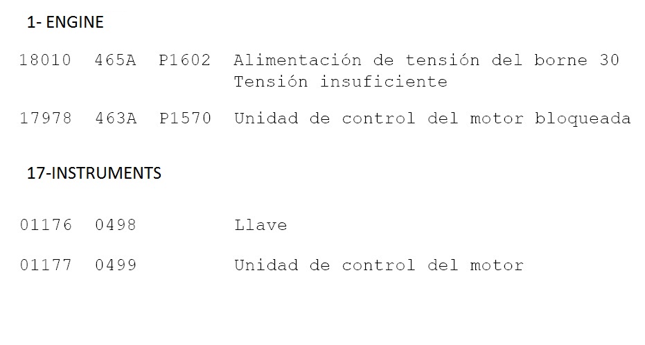

Hola, pues ayer le pase el vag-com al coche.
y cuando lo paso y lo borro, desaparecen, pero si ando un poco vuelven a aparecer.
Tal vez alguien me pueda decir a que son devidos estos fallos.
el 01176- llave,me imagino que sera por no llevar inmo.
pero el resto :conf: :conf:
Si alguien me puede echar una manita¿¿?
gracias
un saludo
Has mirado esta página Galder?
http://wiki.ross-tech.com/wiki/index.php/Category:Fault_Codes
Según esa página:
ERROR 18010
18010/P1602/005634 - Power Supply B+ Terminal 30: Voltage too Low
Possible Causes
Cables on the Battery were removed
Battery weak (voltage)
Generator Disfunction
Possible Solutions
Check Battery Cables
Check/Replace Battery
Check/Replace Generator
Special Notes
If multiple Control Module have Power Supply Faults stored, it's most likely to be one common Problem like the ones shown above. Otherwise when only one or two Control Modules have such Codes stored you better start searching at the individual Power Supply of these Modules.
Terminal 30 means unswitched battery power that is supplied even when the ignition is off. This is not referring to any physical terminal numbered 30.
ERROR 17978
17978/P1570/005488 - Engine Start Blocked by Immobilizer
Possible Symptoms
Engine starting but stalling immediately
Possible Causes
Key(s) not matched
Instrument Cluster not matched
Engine Control Unit (ECU) not matched
Engine Control Unit (ECU) Power Supply faulty
Possible Solutions
Check for Fault Codes in Immobilizer itself (part of Instrument Cluster in many cars, but separate Immobilizer Control Module in some)
Check Immobilizer Measuring Values (usually in Instrument Cluster OR Immobilizer Control Module)
Match Key(s)/Instrument Cluster/Engine Control Unit (ECU)
Check Engine Control Unit (ECU) Power Supply (Relay)
Special Notes
In case of Engine Starting Issues please make sure that you are really experience an Immobilizer related Problem! Even if the Immobilizer engages, the Engine will still start fine but cut out after 2-3 Seconds. If you are NOT experiencing this behavior (e.g. Engine doesn't start at all) your Problem is very likely NOT Immobilizer related.
May be stored in Combination with 01176 - Key: Signal too Low in Immobilizer Control Module.
If no other immobilizer related fault codes are stored and the immobilizer related meas. blocks are fine except Engine Start not allowed, in rare occasions it helps to try cold-booting the car. Remove both battery cables from the battery. Short the battery cables together (away from the battery) for about 15 seconds. Reconnect the battery. (Example)
ERROR 1177
Este no lo encuentro en la página.

Gracias Emilio, por lo que leo, 3 son causados por el inmo que no llevo, 1 por el conector de la bateria,
Menos mal que no es nada grave, lo de la bateria no me extraña nada, con la cantidad de cosas que tengo enchufadas,ijjiijij
no conocia la pagina, gracias.
un saludo

ma interpretacion
lo de la bateria es por haber desconectado la bateria o bien por descarga de la misma
vamos k no es ni un fallo, lo borras y listo y los otros tres no es por no llevares immo es por no tener las llaves emparejadas con el cuadro y la centralita
vamos k no son fallos
saludos

ok, gracias david.
