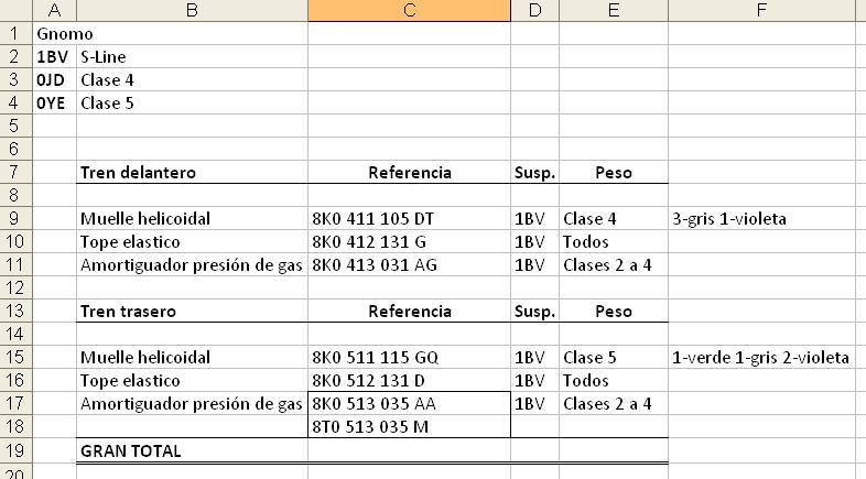

Super-Raton Publicado 10 de Abril del 2011 Denunciar Publicado 10 de Abril del 2011 (editado) E0W = Special edition 7A3 = CD player 4UF = Drivers and front passenger air bag with front passenger air bag deactivation 6XE = Exterior mirrors: electrically foldable and electrically adjustable/heated 5SL = Left exterior mirror: aspherical 5RU = Right exterior mirror: convex (large viewing field) 1KW = Disc brakes, rear J0B = 520 A (92 Ah) battery 1LY = Disc brakes, front 1AS = Electronic stabilization program (ESP) 1BV = Sports suspension/shock absorption 3FA = Without roof insert (standard roof) 5TQ = Decorative titanium inserts 7X1 = Park distance control F0A = No special purpose vehicle, standard equipment 8GU = Alternator 140 A 0Q1 = Label for brake-proportioning values 0YE = Weight range 5 installation control only, no requirement forecast 0JD = Weight category front axle weight range 4 TM4 = 4-cylinder diesel engine 2.0 l unit 03L.M 3NZ = Rear seat bench unsplit, backrest split folding 8BP = Bi-functional headlight with gas discharge lamp U1A = Instrument insert with km/h speedometer,clock, tachometer and trip odometer X3B = National sales program Spain (FBU) 1N3 = Speed-related variable steering assist (Servotronic) 1XW = Leather trimmed multi-function sports steering wheel 8Q3 = Automatic headlight-range adjustment dynamic (self-adjusting while driving) 9GB = Interior light with switch-off delay anddoor pillar switch 8Z4 = Moderate hot country D94 = 4-cyl. turbo diesel engine 2.0 l/100 kW (4V) TDI common rail, base engine: TG3/TJ3/TH3/TU3/TL4/TM4/TP4/TP5/TM3/TW3 7Q0 = Without navigation device C8S = Alloy wheels 8J x 18 7K0 = Without tire pressure warning light 4X3 = Side air bag front with curtain air bag 2K1 = Reinforced bumpers 3L3 = Manual height adjustment for front seats 4KC = Side and rear windows in heat-insulatingglass 3Y0 = Without roll-up sun screen 4K4 = Radio remote controlled central locking 5D7 = Carrier frequency 868 MHz without panic button 1SA = Without additional engine guard 7MG = Emission standard EU5 Q1D = Sports front seats 4GF = Windshield in heat-insulating glass Editado 10 de Abril del 2011 por Super-Raton Responder
Super-Raton Publicado 10 de Abril del 2011 Denunciar Publicado 10 de Abril del 2011 (editado) Estas son las referencias que me salen para esa configuracion de pesos... Saludos! Editado 10 de Abril del 2011 por Super-Raton Responder
GNOMO1979 Publicado 10 de Abril del 2011 Autor Denunciar Publicado 10 de Abril del 2011 gracias super raton... y la cuestion es: porque friky y yo, tenemos el tope trasero acabado en B en vez de D ??? Y EN EL amontiguador presion de gas.. yo veo la pegata, pero solo veo el final: ....35 AR y segun tu tabla seria ....35 AA. no entiendo? que hago? frky y taras bulba????? que deciss.... Responder

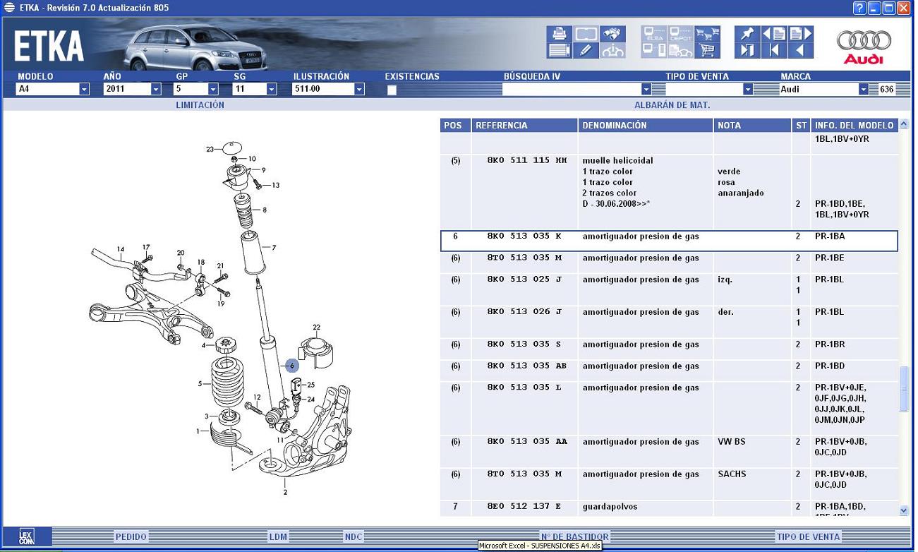

Super-Raton Publicado 10 de Abril del 2011 Denunciar Publicado 10 de Abril del 2011 gracias super raton... y la cuestion es: porque friky y yo, tenemos el tope trasero acabado en B en vez de D ??? Y EN EL amontiguador presion de gas.. yo veo la pegata, pero solo veo el final: ....35 AR y segun tu tabla seria ....35 AA. no entiendo? que hago? frky y taras bulba????? que deciss.... Aqui puedes ver todos los amortiguadores traseros que hay... ninguno acaba en AR... Salduos! Responder
