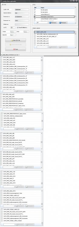

b0cki Publicado 26 de Marzo del 2019 Denunciar Publicado 26 de Marzo del 2019 Dear, I'm sorry for writing in English but perhaps you will have an answer. I installed the subwoofer and the central speaker in my audi a3 8v, built year 2014. Now we are trying to update the MMI firmware with VAG CAN PRO. Unfortunately we cannot see the same file name (9VD sportback) in the ZDC file (please see the attached image - these are the options we have). Which file is correct to upload? Do you have any suggestions? Thanks for your help Responder
b0cki Publicado 26 de Marzo del 2019 Denunciar Publicado 26 de Marzo del 2019 Sorry for the bad image quality. You can download it here: Responder
