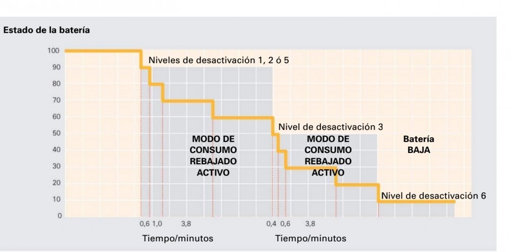

txivory Publicado 29 de Junio del 2018 Denunciar Publicado 29 de Junio del 2018 (editado) Quiescent Current Stage 1, Stage 2, Stage 3, Stage 5 & 6 ,here's the description below for the different stages.Quiescent Current Stage 1In shut-off stage 1 the following functions are restricted or inactive:Restricted functions:- Window lifters- Interior lighting- Boot lighting- Reading lights- Roller blind- Sun roof control- Seat adjusters (manual)- Boot power latchInactive functions:- Ambient lighting- Coming Home- Main beam- Footwell lighting- Interior mirror- Air conditioner- Leaving Home- Proximity sensors (for- Fog lights- Headlight washer system- Mirror fold function- Mirror heating- Daylight driving lights- Washer fluid heating- Exterior door handle illumination- Door power latchesQuiescent Current Stage 2In shut-off stage 2 the following functions are restricted or inactive:Restricted functions:- Window lifters- Radio clock- Reading lights- Sun roof control- Seat adjusters (manual)- Boot power latchInactive functions:- All infotainment components except telematics- Ambient lighting- Coming Home- Main beam- Footwell lighting- Interior lighting- Interior mirror- Air conditioner- Boot lighting- Leaving Home- MMI open/close manual- Proximity sensors (for- Fog lights- Tyre pressure monitor receiver- Roller blind- Headlight washer system- Mirror fold function- Mirror heating- Daylight driving lights- Washer fluid heating- Exterior door handle illumination- Door power latchesQuiescent Current Stage 3In shut-off stage 3 the following functions are restricted or inactive:Restricted functions:- Radio clock- Reading lights- Sun roof control- Seat adjusters (manual)Inactive functions:- All infotainment components except telematics- Ambient lighting- Coming Home- Window lifters- Main beam- Fingerprint functions- Radio remote control- Footwell lighting- Interior lighting- Interior mirror- Air conditioner- Boot lighting- Leaving Home- MMI open/close manual- Proximity sensors (for- Fog lights- Tyre pressure monitor receiver- Roller blind- Headlight washer system- Mirror fold function- Mirror heating- Daylight driving lights- Washer fluid heating- Exterior door handle illumination- Power latchingQuiescent Current Stage 5Shut-off stage for auxiliary heater (shut-off stage 5):If this shut-off stage is activated the auxiliary heater is subject to the following restriction:Fans and glow plugs remain in operation for max. 1 hour.As shut-off stage 5 is only set when shut-off stages 1 and 2 have been passed, allconsumer restrictions entailed by stages 1 and 2 are also active.Quiescent Current Stage 6Shut-off stage 6:Shut-off stage 6 ensures that the control units only remain "awake" briefly below a specificbattery charge level. This function is only activated in response to so-called wake-up events(such as a door handle being turned) for the CAN/Most bus. Editado 29 de Junio del 2018 por txivory Responder
txivory Publicado 29 de Junio del 2018 Denunciar Publicado 29 de Junio del 2018 No se lo que entendéis los demás pero yo entiendo que a los 18 minutos si o sí entra el nivel de desactivación 6 y marca batería baja. Responder

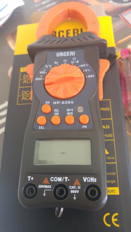

Baco3434 Publicado 23 de Julio del 2018 Autor Denunciar Publicado 23 de Julio del 2018 He comprado una otra pinza amperimetrica y los valores fluctúa entre 0.80A y 1.50A después de media hora con el coche cerrado. He mirado el voltaje de los fusibles por si tienen consumo y dan todos 0.00. Con el coche cerrado. Con el coche abierto sin contacto me consume el fusible 12 del portáfusiblestiles negro del lado del acompañante 0.20A El manual dice que a comunicación pero no se exactamente que es. Responder
