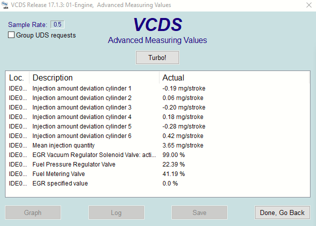

muskletech Publicado 12 de Junio del 2020 Denunciar Publicado 12 de Junio del 2020 En 15/1/2020 a las 11:15, Javier Barea Egaña dijo: 140 EGR specified value 11.4 % 141 EGR Vacuum Regulator Solenoid Valve; activation 88.24 % 199 Fuel Metering Valve 43.26 % 201 Fuel Pressure Regulator Valve 25.00 % 237 Injection amount deviation cylinder 1 0.09 mg/stroke 238 Injection amount deviation cylinder 2 0.23 mg/stroke 239 Injection amount deviation cylinder 3 -0.23 mg/stroke 240 Injection amount deviation cylinder 4 0.45 mg/stroke 241 Injection amount deviation cylinder 5 -0.13 mg/stroke 242 Injection amount deviation cylinder 6 -0.38 mg/stroke 744 Main_injection_quantity 3.64 mg/stroke Ahi mis datos, en ralentí con 600 rpm y las dichosas vibraciones/tirones Responder
