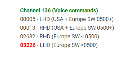

Shadax Publicado 24 de Octubre del 2019 Denunciar Publicado 24 de Octubre del 2019 Échale un ojo a ver si lo tienes todo como esto ( te marco en rojo los valores ): MÓDULO 56 ( Navigation System ) Coding -> Function 07 0?xxxxx: Model 1 - Lamborghini2 - Audi A3 (8P)3 - Audi A4 (> 2004) 4 - Audi A4 Cabriolet (> 2004) 5 - Audi A6 (< 2004) 6 - Audi TT (> 2007) (sw US 0150+, EU 0500+) 7 - Audi R8 (sw US 0150+, EU 0500+)0x?xxxx: Diagnostics for front speakers0 - activ 1 - inactiv0xx?xxx: Sound characteristics 0 - linear1 - Audi A4 (> 2004) 2 - Audi A6 (< 2004) 3 - Audi A4 Cabriolet (> 2004) 4 - Audi TT (> 2004) 5 - Audi A3 (8P) 9 - Bose Soundsystem0xxx?xx: Telephone/telematics 1 - no telephone (supply voltage for microphone actively) 2 - Mobile phone preparation (Temic - Speisesp. Microphone inactively) 3 - Mobile phone preparation (Cullmann - Speisesp. Microphone inactively) 4 - Mobile phone preparation (Nokia - Speisesp. Microphone inactively) 5 - Telematics Europe (supply voltage microphone inactively) 6 - Telematics US (supply voltage microphone inactively)7 - Base plate diagnostic capable with comfort control0xxxx?x: Options I1 - default 2 - Digital-Radio 3 - Satelite-Radio 4 - Satelite- and Digital-Radio 5 - AUX in (Euro sw 0650+) 6 - AUX in and DAB (Euro sw 0650+)0xxxxx?: Options II 1 - default 2 - TV-Tuner 3 - CD-Changer 4 - TV-Tuner and CD-Changer5 - Multifunction Steering Wheel 6 - TV-Tuner and Multifunction Steering Wheel 7 - CD-Changer and Multifunction Steering Wheel 8 - TV-Tuner, CD-Changer und Multifunction Steering Wheel Adaptation -> Function 10 Channel 001 (Tires)Te toca buscar la combinación adecuada a tu diámetro de llanta.Channel 002 (GALA) 0 - Self calibration 8 - Audi A6 (4B) 43 - Audi A3 (8P)45 - Audi A4 (> 2004)Channel 003 (Language) 0 - German 1 - English (UK only) 2 - French 3 - Italian5 - Spanish 7 - English (USA only)Channel 004 (Rear view camera - US SW Lamborghini mode only, EU SW only with SW 0600+)0 - disabled 1 - enabledChannel 005 (TV in motion) 0 - off1 - up to 5 km/h 250 - unlimited ( Por defecto no se puede activar esta opción )Channel 010 (Region)0 - Northern hemisphere (Europe, North America) 1 - Southern hemisphere (Australia) 2 - Southern hemisphere (South Africa)Channel 018 (Startup Logo, sw US 0150+/EU 0500+) 0 - Default 1 - S3 (EU 0500+ only) 2 - S4 (EU 0500+ only) 3 - RS4 (EU 0500+ only) 4 - TT 5 - R8Elige el que te dé la gana. Es la pantalla de inicio del RNS-EChannel 136 (Voice commands) 00005 - LHD (USA + Europe SW 0500+) 00013 - RHD (USA + Europe SW 0500+) 02632 - RHD (Europe SW < 0500)03226 - LHD (Europe SW <0500) MÓDULO 17 ( Instrument cluster ) Coding -> Function 07 xxxx?xx: Country 0 = Germany1 = Rest of World (RoW - Left Hand Steering) 2 = USA 3 = Canada 4 = Great Britain (Right Hand Steering) 5 = Japan (Left Hand Steering) 6 = Arabien States 7 = Australia 8 = Rest of World (RoW - Right Hand Steering) 9 = Japan (Right Hand Steering)xxxxx?x: Seat Belt Warning 0 = No Seat Belt Warning1 = Europe-NCAP (permanent visual warning and acoustic warning active for 91 seconds) 2 = USA and Canada OLD (visual and acoustic warning for 6 seconds) 3 = USA and Canada NAR-NEW (permanent visual warning and acoustic warning active every 30 seconds) 4 = Europe-NCAP (including passenger - permanent visual warning and acoustic warning active for 91 seconds) 5 = USA and Canada OLD (including passenger - visual and acoustic warning for 6 seconds) 6 = USA and Canada NAR-NEW (including passenger - permanent visual warning and acoustic warning active every 30 seconds) Adaptation -> Function 10 Channel 62+04 - Navigation+23 - Bluetooth MÓDULO 16 ( Steering Wheel ) Coding -> Function 07 00?xxxx: Transmission 0 = Manual Transmission 1 = Automatic Transmission Elige el valor que se corresponda.00x?xxx: Steering Wheel 0 = 3-Spoke, w/o Tiptronic, w/o Multi-Function 1 = 3-Spoke, with Tiptronic, w/o Multi-Function 2 = 4-Spoke Multi-Function (with Radio Control) 3 = 4-Spoke Multi-Function (with Radio/Telephone Control)4 = 4-Spoke Multi-Function (with Radio/Telephone/Voice Control), supongo que tendrás un volante MF. 00xx?xx: Tiptronic/Heating +1 = Tiptronic on Steering Wheel Si tienes levas, le sumas +1 al valor que tengas.00xxx?x: Cruise Control/Board Computer 0 = no Board Computer, no Cruise Control 1 = Board Computer, no Cruise Control 2 = no Board Computer, Cruise Control 4 = Board Computer, Cruise ControlMarca el 1 o el 4, según tengas control de crucero o no.00xxxx?: Rear Wiper0 = w/o Rear Wiper 1 = with Rear Wiper 2 = with Rear Wiper 2012 MÓDULO 77 - Telephone ( Bluetooth ) Coding -> Function 07 0?xxxxx: Brand0 = Audi 1 = Seat0x?xxxx: Functions 0 = Basic (for RNS-E basic/Radio)1 = Comfort (for RNS-E high/RNS-Low)0xx?xxx: Steering Wheel 0 = No Multi-Function OR Standard Steering Wheel (Old Style without Menu Thumb Wheels)1 = Modular Steering Wheel (New Style with Menu Thumb Wheels)0xxx?xx: Installation List 1 = Diagnostics via CAN 2 = Multi-Function Steering Wheel, Diagnostics via CAN 3 = Head Unit (e.g. RNS-E), Diagnostics via CAN 4 = Multi-Function Steering Wheel, Head Unit (e.g. RNS-E), Diagnostics via CAN 5 = Diagnostics via K-Line 6 = Multi-Function Steering Wheel, Diagnostics via K-Line 7 = Head Unit (e.g. RNS-E), Diagnostics via K-Line8 = Multi-Function Steering Wheel, Head Unit (e.g. RNS-E), Diagnostics via K-Line0xxxx?x: Language (Voice Control)0 = Voice Control OFF OR via external Device (e.g. RNS-E) 1 = German 2 = English (UK) 3 = French 4 = Italian 5 = Spanish 6 = Czech 7 = English (US) 8 = French (CA) 9 = Speaker dependent (Voice Commands inactive, Acoustic Name Selection active)0xxxxx?: Language (Display) 0 = No Display 1 = German 2 = English (UK) 3 = French 4 = Italian5 = Spanish 6 = Czech 7 = English (US) 8 = French (CA) Adaptation -> Function 10 channel 1331 - BT ACTIVATIONchannel 1340 - Handsfree over BTchannel 1351234 - Bluetooth PIN A ver si puede ayudarte esto en algo... Responder

§Gandalf§ Publicado 3 de Diciembre del 2019 Autor Denunciar Publicado 3 de Diciembre del 2019 Pues dicho y hecho. Revisado todo, había algún número que no lo tenía puesto igual, ya cambiado, de nuevo tengo agenda e información del teléfono en el FIS, genial. Sin embargo, sigo sin poder ver las instrucciones del navegador en el FIS, solo lo veo en el RNS-E y por voz claro, pero en FIS no sale nada. No se que revisar para ésto. ¿Alguna idea alguien? Lo único que no he podido cambiar ha sido esta parte, no me deja meter el número indicado, adjunto foto. GRACIAS OTRA VEZ. Responder
