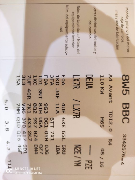

Yomismo83 Publicado 23 de Enero del 2021 Autor Denunciar Publicado 23 de Enero del 2021 Tengo estos códigos, pero no sé si alguno de ellos corresponde a los muelles Responder
Shadax Publicado 23 de Enero del 2021 Denunciar Publicado 23 de Enero del 2021 (editado) Ahí lo tienes desglosado: 4GF WSS Windshield in heat-insulating glass QI6 SEA Service indicator 30 000 km or 2 years ( variable ) Q1D VOS Sports seats in front 7MM AGM Emission standard EU6 plus 1SA TWU Without additional front underbody guard 5D1 TRF Carrier frequency 433.92 MHz-434.42 Mhz 4I7 TKV Central locking system "Keyless-Go" without SAFELOCK 3Y0 SSR Without roll-up sunshade VW6 SSH Side and rear windows 3L3 SIE Manual height adjustment for front seats 2K7 SFS Reinforced bumpers 4X3 SAB Side airbag in front, with curtain airbag 7K1 RDK Direct tire pressure monitoring system 40R RAD Alloy wheels 8J x 18 7UF NAV Navigation system - Standard DN4 MOT 4-cyl. turbo diesel engine 2.0 l/110 kW (4V) TDI common rail; b.engine T37/T6F TS1/TR1/T0P/T0N/T13/T29/TM4/TD1/TI9/T1I 8Z4 MKU Moderate hot country 9S7 MFA Multi-function display/on-board computer"Top" 8Q2 LWR Automatic headlight range adjustment static 1XC LRA Multifunction steering wheel QZ7 LEN Power steering U5A INS Instrument cluster, km/h speedometer 8IH HSW Gas discharge headlamps (D5/D7 system) 3NT HIS Rear seat bench unsplit, backrest split folding (three pieces) with center armrest TD1 GMO 4-cylinder diesel engine 2.0 l unit 04L.C 0JG GKV Weight category front axle weight range 7 0YH GKH Weight range 8 installation control only, no requirement forecast 0G1 GES Gearshift lever 9G3 GEN Alternator 120-180 A F0A FZS No special purpose vehicle, standard equipment 7X1 EPH Park distance control 5TT EIH Decorative inserts 3FA DEI Without roof insert (standard roof) 1LA BAV Disk brakes in front J4E BAT Battery 420 A (79 Ah) 1KD BAH Disk brakes in rear 5RU ASR Right exterior mirror: convex (large viewing field) 5SL ASL Left exterior mirror: aspherical 6XE ASE Exterior mirrors, power-folding and power-adjustable/heated 4UF AIB Driver and front passenger airbag with front passenger airbag deactivation E0A AAU No special edition Editado 23 de Enero del 2021 por Shadax Responder
Tineo Publicado 23 de Enero del 2021 Denunciar Publicado 23 de Enero del 2021 (editado) hace 20 minutos, Yomismo83 dijo: Tengo estos códigos, pero no sé si alguno de ellos corresponde a los muelles 1BA: tren de rodaje (en este caso estándar) 0JG: nivel de pesos delantero 0YH: nivel de pesos trasero Lo suyo sería poner un muelle 1BV con esos niveles de pesos... Y un amortiguador acordé a ese rango más corto Editado 23 de Enero del 2021 por Tineo Responder
qwertyui Publicado 23 de Enero del 2021 Denunciar Publicado 23 de Enero del 2021 Gracias @shadax! Lo miro esta noche en el etka y te digo si consigo sacarlo. En el concesionario no les ha dado la gana de mirarlo... Parece que tiene nivel 7 delante y 8 detras Responder
