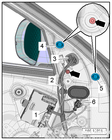

Dersu Uzala Publicado 20 de Agosto del 2015 Denunciar Publicado 20 de Agosto del 2015 Pues a mí, lamentablemente, no me sirve de mucho. Alguien me puede decir qué errores son éstos: Address 42: Door Elect, Driver (J386) Labels: None Part No SW: 4G8 959 793 D HW: 4G8 959 793 Component: TSG FA H05 0212 Revision: -------- Serial number: -------------- Coding: 011C16205000628002080013 Shop #: WSC 02312 785 00200 VCID: 41835BDDD892EB16 Faults Found:01482 - Motors for Central Locking 006 - Short to Plus - Intermittent Freeze Frame: Fault Status: 00100110 Fault Priority: 3 Fault Frequency: 1 Reset counter: 17 Mileage: 52434 km Time Indication: 0 Date: 2015.08.19 Time: 13:19:2401482 - Motors for Central Locking 007 - Short to Ground - Intermittent Freeze Frame: Fault Status: 00100111 Fault Priority: 3 Fault Frequency: 1 Reset counter: 17 Mileage: 52434 km Time Indication: 0 Date: 2015.08.19 Time: 13:19:2402116 - Mirror Adjusting Motor 006 - Short to Plus - Intermittent Freeze Frame: Fault Status: 00100110 Fault Priority: 3 Fault Frequency: 1 Reset counter: 17 Mileage: 52434 km Time Indication: 0 Date: 2015.08.19 Time: 13:19:2402116 - Mirror Adjusting Motor 007 - Short to Ground - Intermittent Freeze Frame: Fault Status: 00100111 Fault Priority: 3 Fault Frequency: 1 Reset counter: 17 Mileage: 52434 km Time Indication: 0 Date: 2015.08.19 Time: 13:19:2402117 - Motor for Mirror Folding 006 - Short to Plus - Intermittent Freeze Frame: Fault Status: 00100110 Fault Priority: 3 Fault Frequency: 1 Reset counter: 17 Time Indication: 002117 - Motor for Mirror Folding 007 - Short to Ground - Intermittent Freeze Frame: Fault Status: 00100111 Fault Priority: 3 Fault Frequency: 1 Reset counter: 17 Time Indication: 0----------------------------------------------------------------- Address 5F: Information Electr. (J794) Labels: None Part No SW: 4G0 035 182 J HW: 4G0 035 182 J Component: RMC Cnct Plus H52 0761 Coding: 0100000001515F47472B060301010000000000 Shop #: WSC 02391 785 00200 VCID: 2855E6795BE83A9 Subsystem 1 - Part No SW: 4G0 919 603 HW: 4G0 919 603 Component: DU6 Basic H42 0084 Subsystem 2 - Part No SW: 4G1 919 610 B HW: 4G1 919 610 B Component: E380 BDT C7 H11 02041 Fault Found:03787 - Rotation Mechanism for Display Module Front 003 - Mechanical Failure Freeze Frame: Fault Status: 01100011 Fault Priority: 4 Fault Frequency: 2 Reset counter: 232 Mileage: 52434 km Time Indication: 0 Date: 2015.08.19 Time: 13:20:45 Freeze Frame: Voltage: 12.30 V El problema que tengo es que el retrovisor izquierdo no se abate ni se abre. El resto funciona todo perfectamente. Responder
ALL70 Publicado 20 de Agosto del 2015 Denunciar Publicado 20 de Agosto del 2015 La verdad es que no veo ninguno de esos errores, ni en el listado de ross-tech ni en otro lado. Pero si me permites teorizar, tiene toda la pinta de que el motorcillo que mueve el espejo ha cascado o se le ha soltado un cable, coincidiría con todos los errores. Saludos! Responder
Dersu Uzala Publicado 20 de Agosto del 2015 Denunciar Publicado 20 de Agosto del 2015 La verdad es que no veo ninguno de esos errores, ni en el listado de ross-tech ni en otro lado. Pero si me permites teorizar, tiene toda la pinta de que el motorcillo que mueve el espejo ha cascado o se le ha soltado un cable, coincidiría con todos los errores. Saludos! Gracias ALL70, sabéis si hay algún manual que me sirva para desmontarlo y echarle un vistazo? Se trata de un A6 C7. Responder
ALL70 Publicado 21 de Agosto del 2015 Denunciar Publicado 21 de Agosto del 2015 A ver si esto te sirve. Yo tampoco veo en el dibujo un 7, con lo que creo se referirán al 6. Retrovisor exterior: desmontar y montar Desmontar – Desmontar el guarnecido del marco de ventanilla – Desacoplar el conector eléctrico -2-, extrayendo para ello el fusible -1- y oprimir el desbloqueo. – Desacoplar el conector eléctrico -7-. – Sacar los tapones -4, 5-. – Desenroscar los tornillos -flechas-. – Quitar el alojamiento para la unidad de reglaje del retrovisor y sacar al mismo tiempo la boquilla de estanqueidad -4- con mazo de cables -3- a través del hueco de la carrocería. Montar El montaje se efectúa en el orden inverso, teniendo en cuenta lo siguiente: – En vehículos equipados con cámara para vigilancia del entorno se tiene que calibrar nuevamente la cámara para vigilancia del entorno delantera Responder
Dersu Uzala Publicado 21 de Agosto del 2015 Denunciar Publicado 21 de Agosto del 2015 Gracias de nuevo ALL70. El mío lleva Side Assist, seguro que me tocaría pasar por el conce a que lo calibren, prospere o no la reparación. Creo que voy a esperar a la siguiente revisión a ver qué me dicen, pero si he de cambiar todo el espejo por el motorcillo de plegado creo que no lo haré, entre una cosa y otra se acercará la broma a 600 euros. Responder
